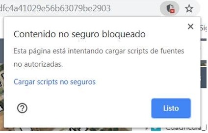

I´ve found what was going wrong there, at least for the Spanish Cadastre WMS service.
When you first open a pop-up window from that source, may the web browser send you a warning about "you are trying to load non-secure scripts"? If you allow that, WMS´s pop-up should work fine.
