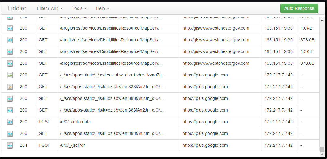

I grabbed your REST service and added it as an item and built a quick basic viewer. I did not experience the same phenomenon. How did you consume your ArcGIS Server service into AGOL (individual layer per item or entire service as an item)? I watched the communication via Fidler on your app and it was making hundreds of calls back to your ArcGIS Server. I consume3d your entire service and my app made significantly fewer calls. If you have Chrome, add the Fiddler Add-In and watch the communication. Might be the way you consumed your layers into AGOL or how they were added (maybe altered) in the web map.

Okay, I suspect it has something to do with that....hopefully tech support can explain what is happening. Fiddler is a nice application to watch internet traffic. I included a snapshot below, but I could essentially see hundreds of calls to your AGS box when I started the application.
Fiddler free web debugging proxy
