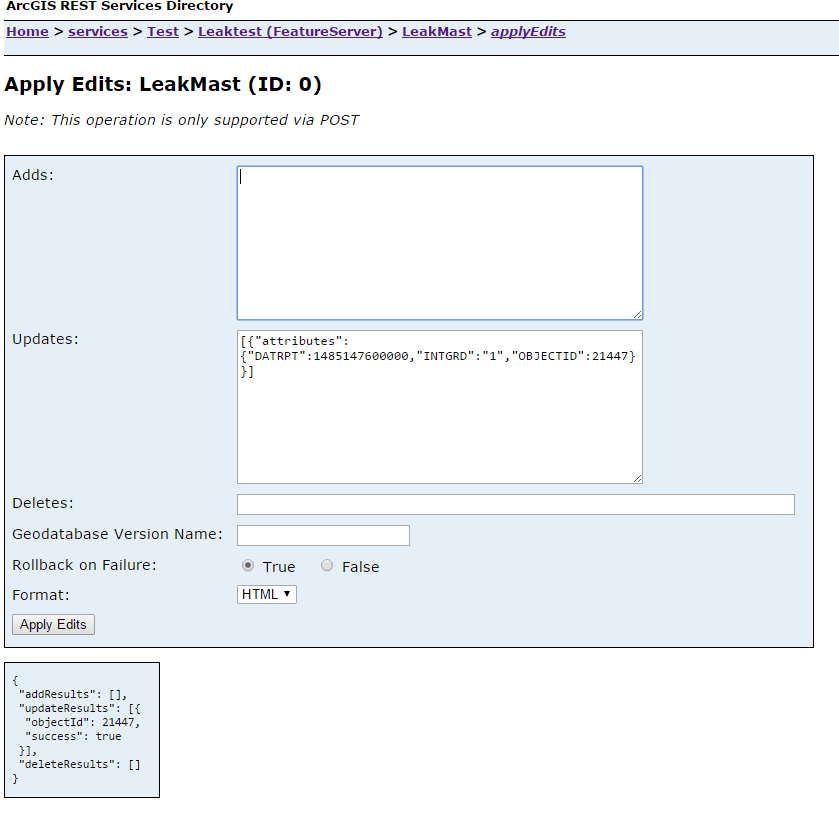

[{"attributes":{"FacilityID":null,"LeakNumber":null,"DATRPT":1485147600000,"INTGRD":null,"CURGRD":null,"INTPCT":null,"CURPCT":null,"SVY":null,"DSC":null,"FACTP":null,"PSZ":null,"PMTL":null,"PRSR":null,"JNTTP":null,"FITTP":null,"LOC":null,"LOCON":null,"LOCAT":null,"CS":null,"SUBCS":null,"PREM":null,"DIR":null,"SFX":null,"House":null,"STR":null,"ARA":null,"CITY":null,"ZIP":null,"SVCADR":null,"DATRCK":null,"RCKBY":null,"DATRGR":null,"RGRBY":null,"DATRPR":null,"RPRBY":null,"RPRMTH":null,"RPRMTHOTH":null,"WorkOrder":null,"TBREN":null,"PAGE":null,"INITServiceOrder":null,"PROJID":null,"LELPCT":null,"InstallDate":null,"OBJECTID":21452}}]
So the wab app builder application doesn't know that the database set the FacilityID and LeakNumber fields, so when it send the update it overwrites them back to null.  So what I have learned is each time a field is updated it sends an update for all fields.  I originally have the LeakNumber field visible and editable, then I made it not editable, then hid it completely thinking that might stop it from sending the null values, but no luck.  If I go directly to the rest endpoint and send an update that does not include anything for the LeakNumber or FacilityID fields they do not get overwritten and the update for the field still succeeds.
Rest endpoint Update
I am trying to understand why this might be necessary, but can't come up with a reason.  In my mind it would make more logical sense to only send the update for the field(s) you are changing.  That said there may be a a simple explanation I don't see.
