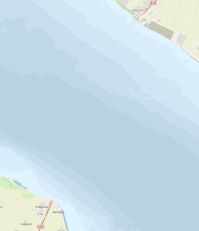

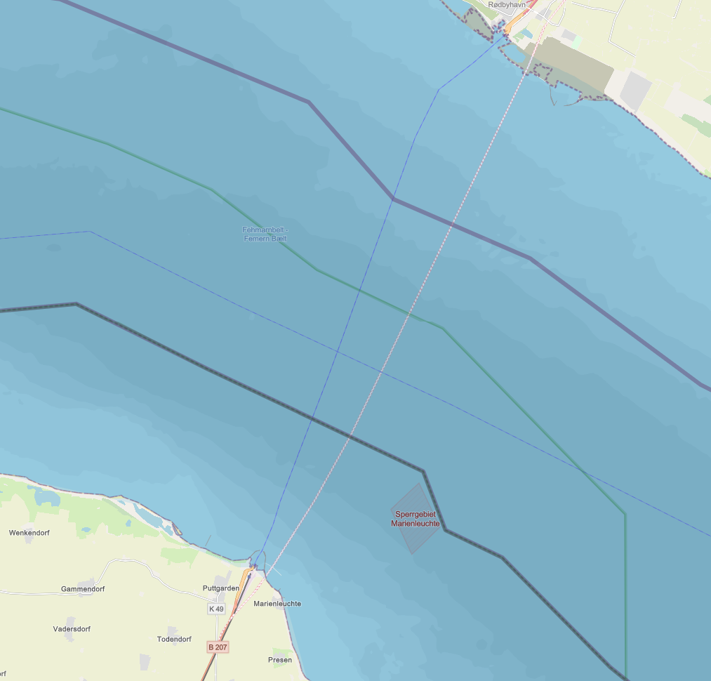

I was creating a web map app, adding a web map that I styled just to realize that the app is interpreting the colors and apparently also the blending settings in a different way than the map is set to.
To illustrate... this is my map with some bathymetry data styled and in blending mode 'Multiply', showing OpenStreetMap information in the waters.
This is the app, showing its interpretation of the map above...
 You can clearly tell, the blending option is disregarded, and I assume thereby the colors for the bathymetry are changed as well!
I created the app with the Web AppBuilder on a 10.9.1 portal, where the map was created in the Map Viewer (not the classic).
Did I miss a setting enabling blending, or is this a bug?
On another note... one of the layers I show in the map has labels turned on and shows them nicely in the map. When I visualize the layer in the app, the labels are not shown by default, but instead the user has to manually enable them through some settings menu of the layer. Again, that is altering the Web Map when used in the App

Web AppBuilder is built on Javascript 3.x, which does not have the blend capabilities available in 4.x. YOu would have to use Experience Builder to get the rendering options available in the new Map Viewer.
