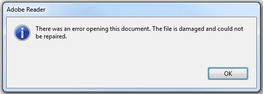

I have just placed my first app on our test server using the Web AppBuilder Dev Edition (1st full release, not beta) and went to print from the app.  Print looks good and I saved it to my desktop.  When I try to open the PDF I get an error, which is shown below.  I am using Google Chrome as my browser of choice.  I have noticed that if I try saving the PDF a second time it seems to work.
If I try using IE and do the exact same thing...print to PDF, save to desktop, the PDF opens fine.
Is there a reason saving the PDF from Chrome is a little 'off'...?
