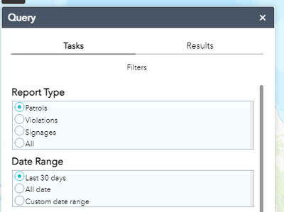

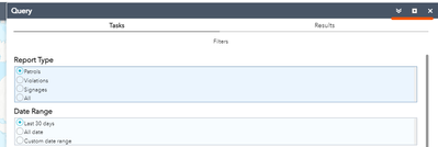

Hi @RobertScheitlin__GISP ,
For desktop off-panel custom widget, is there any way to show the fold and maximize icon button? I tried to change the breakPoints 600 to 1024, but the whole app is switched to mobile mod so the widget is fixed to right side with bigger width and can't resize.
Just found the off-panel widget has only the attribute - closable, any way to set the attribute like foldable?
