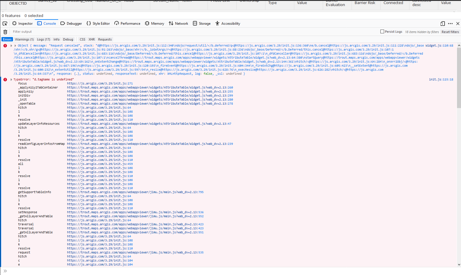

MatthewMayfield
Thanks for your response, Robert. Yes, there is an error in the console related to the Attribute Table widget. It reads "d.tagName is undefined". See abbreviated screenshot. Any ideas based on that?
error messages in console
PhilLarkin1
If you have other layers in the app, does the same issue occur? I'm curious if the schema of the layer you are concerned about has been changed recently. d.tagname looks like it might be missing.
MatthewMayfield
I think you may be right. The schema of the main operational layer has changed several times. Building a new app (I'm using Web AppBuilder) from the same map results in an error-free Attribute Table widget. Thanks!
