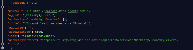

after registration I insert appID to config.json code
config.json

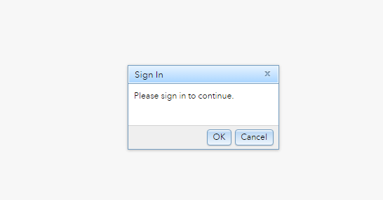

URL: http://vlmiesta.konocestuje.sk
but its requires sign in ti visit app 😕

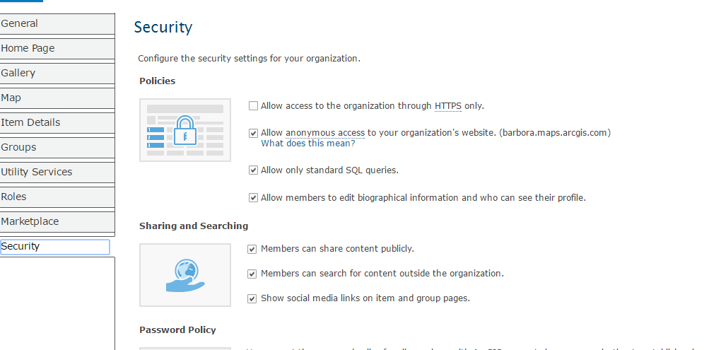

security settings
I have also allowed anonymous acces in my account because I thought this was the problem, but it was not..

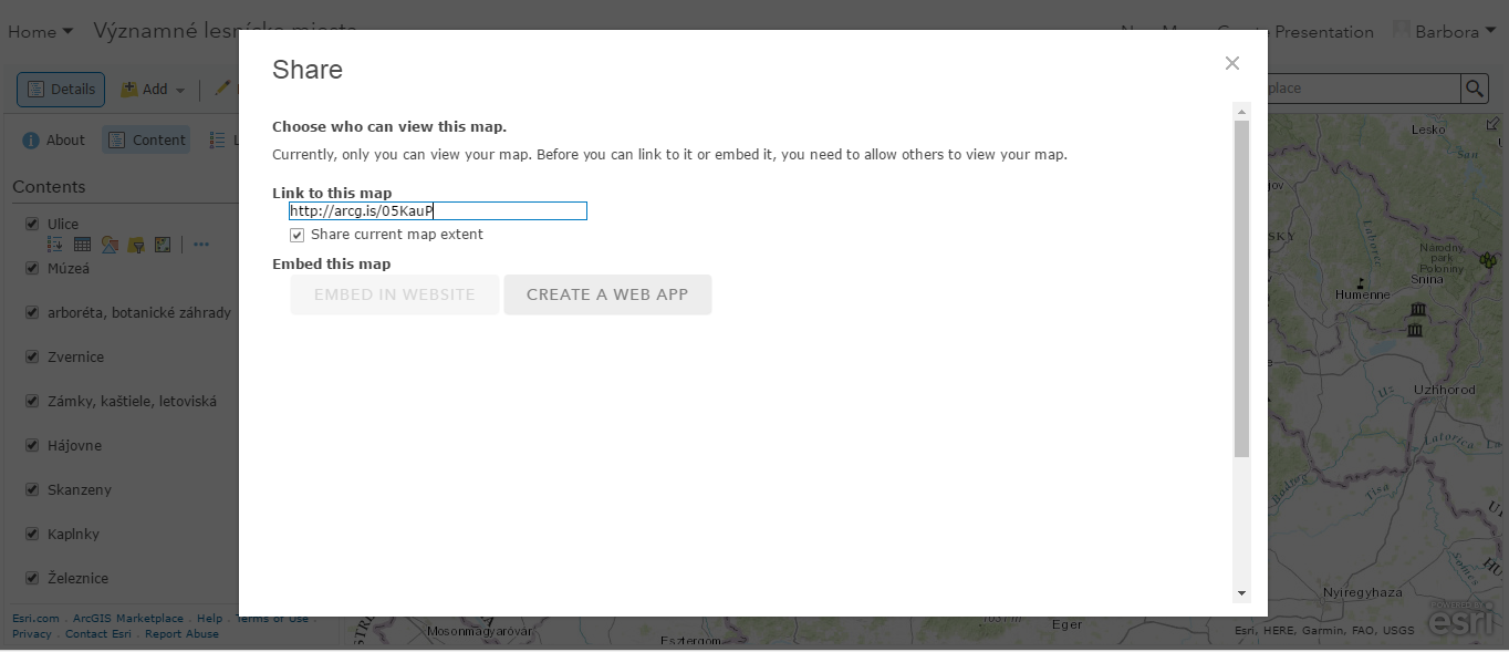

Thanks Robert, but when I wan´t to share it, I can´t do it, because it doesn´t give me this option..
and I have no idea how I can do it otherwise

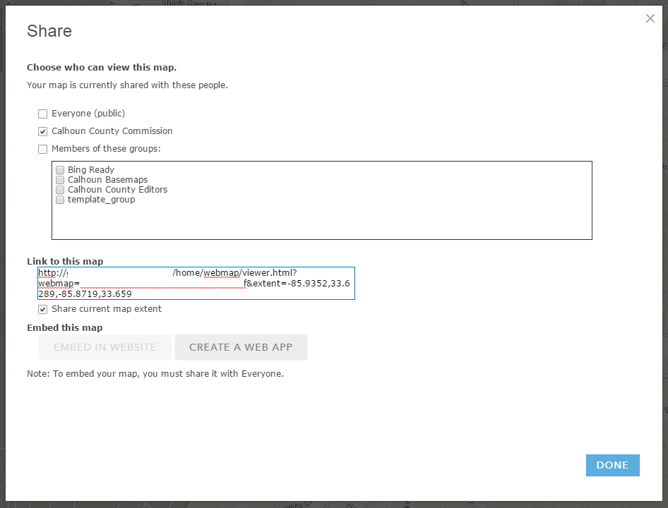

   That is strange this is what a normal share dialog looks like:
