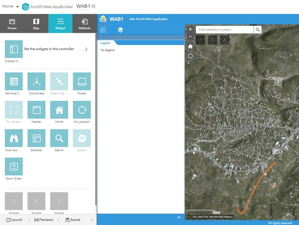

Thank you for your reply, I tried to add a base map with 28191 WKID, and the issue persist to exist. and unfortunately I couldn't delete the "World Hillshade" base map, and the new base map does not appear on the WAB map despite the fact that it is appeared in the map itself, and the “coordinates” does not expanded by default. please see the below:
RobertScheitlin__GISP
MVP Emeritus
Because you did not remove the esri basemap completely your web map is still in WKID 102100 and this is the still the same issue.

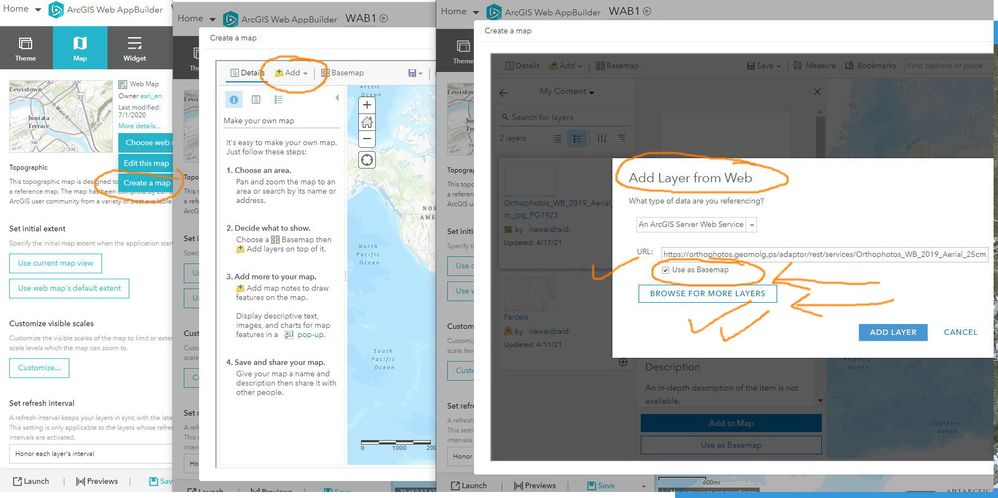

Normally when you add data (from a tiled/cached service) it will ask if you want to add it as a basemap. This is what you want to do. It looks like you some how added it to the topographic esri basemap group.
MajdoleenO_A__Awadallah
Thank you Robert, it works like a charm.
I tried the two options to add the layer as a base map and it works fine.
the first options as shown below to add the tile map from my content
Second option: from WEB
and the coordenate will expanded by default, but why is the default unit is in feet and not meter??
the good thing that I switch it to metric and it works fine:
Thank you
