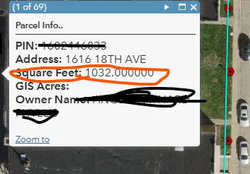

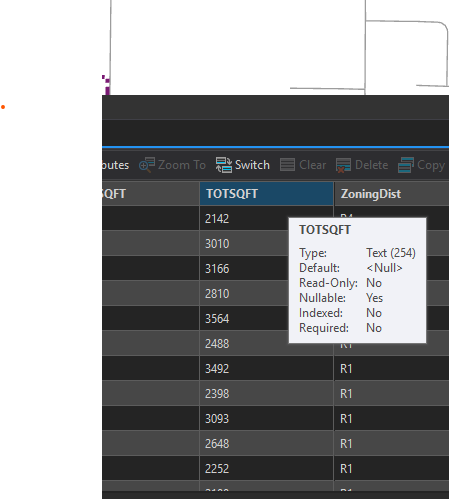

toaSqft_Text.pngsquareFeetRound.png Hi all, looking to round the square feet value to nearest hundredth. Is there a way to do this programmatically inside of ArcPro?

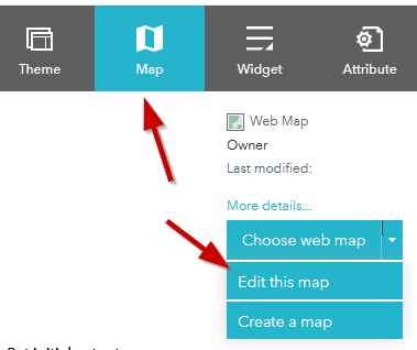

You will need to use the "Edit Map" functionality to transfer onto the Web app:

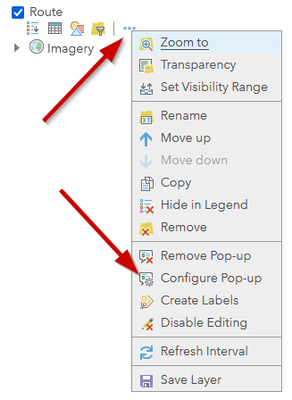

Once inside, you can go to the layer, then to configure popups:

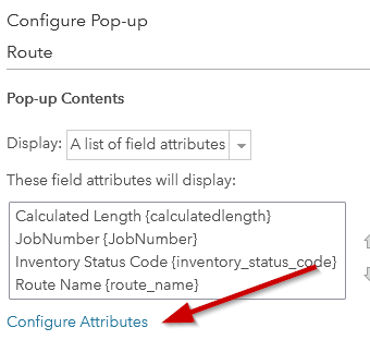

Then to Configure Attributes:

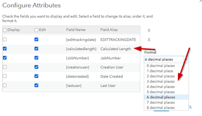

Finally selecting the attribute would let you change the format:
I find it kind of strange that it's changing the text field to numeric, so you may need to use Attribute expressions below the "Configure Attributes" button as well, but let me know if needed!
