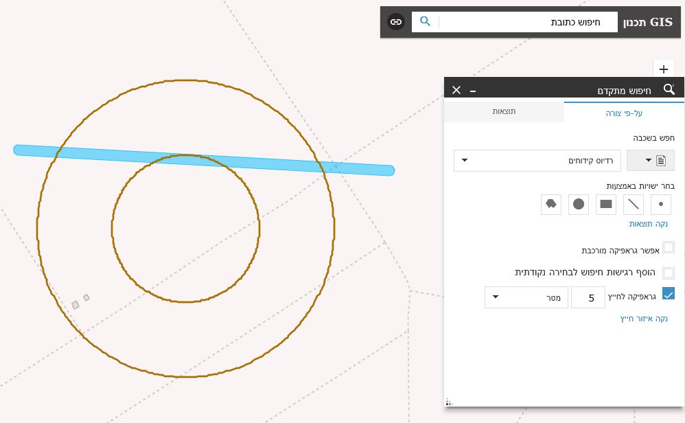

SvivaManager
What I mean is that the buffer runs over the shape of the eSearch tool.
Is it possible to make it run on the search results polygon/point ? I've attached a picture to demonstrate - it's the line I draw that has a buffer but I'm trying to buffer the result itself..
esearch buffer
RobertScheitlin__GISP
MVP Emeritus
Sviva,
   When using by shape the buffer will always be applied to the drawn shape. If you want to buffer the results of the by shape or by value then you must use the by spatial tab to do so.
