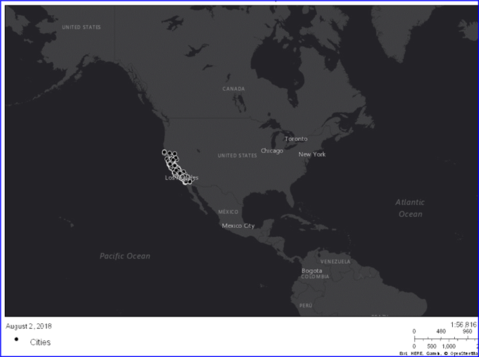

pls see the json below that uses featureLayer.
{ "operationalLayers": [{ "id": "dark-gray-base-layer", "title": "World Dark Gray Base", "opacity": 1, "minScale": 0, "maxScale": 0, "url": "https://services.arcgisonline.com/ArcGIS/rest/services/Canvas/World_Dark_Gray_Base/MapServer", "token": null }, { "id": "Cities", "title": "Cities", "opacity": 1, "minScale": 0, "maxScale": 0, "url": "https://services.arcgis.com/Wl7Y1m92PbjtJs5n/ArcGIS/rest/services/Californiaaa/FeatureServer/4", "token": null, "layerDefinition": {"drawingInfo": { "renderer": { "symbol": { "type": "esriSMS", "color": [0, 0, 0, 255], "xoffset": 0, "yoffset": 0, "size": 6, "style": "esriSMSCircle", "outline": { "type": "esriSLS", "color": [255, 255, 255, 255], "width": 0.5, "style": "esriSLSSolid" } }, "type": "simple" } } } }, { "id": "dark-gray-reference-layer", "title": "World Dark Gray Reference", "opacity": 1, "minScale": 0, "maxScale": 0, "url": "https://services.arcgisonline.com/ArcGIS/rest/services/Canvas/World_Dark_Gray_Reference/MapServer", "token": null }], "mapOptions": { "extent": { "spatialReference": { "latestWkid": 3857, "wkid": 102100 }, "xmin": -18971512.898950197, "ymin": 1292277.143967695, "xmax": -186348.82759027556, "ymax": 8004059.723630667 }, "spatialReference": { "latestWkid": 3857, "wkid": 102100 }, "scale": 73957190.948944 }, "exportOptions": { "dpi": 96 }, "layoutOptions": { "titleText": "Esri test reproduction", "authorText": "Esri", "copyrightText": "Esri inc", "customTextElements": [], "scaleBarOptions": {  }, "legendOptions": { "operationalLayers": [{ "id": "Cities" }] } } }
... if you use this json as a value to WebMap_as_JSON parameter with the print service available on sampleserver6, and execute, you will get the following output.
please let me know if you have any question. Thanks.
