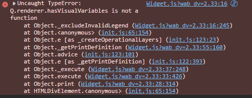

When certain image service layers are visible in the map, the print widget throws the following error and refuses to print:
The widget shows "Error, try again" and hovering over the red exclamation mark shows "Q.renderer.hasVisualVariables" is not a function. WAB seems to be struggling to output the legend, but the "Include in Legend" option is unchecked for this layer.

Blihack
We were able to fix this issue by reuploading the orthophoto layer to our portal/image server and adding it to the web map again. However, changing the symbology of the ortho layer caused the issue to reappear. Even changing the symbology back to the default did not remove the issue, it had to be readded to the web map again.
