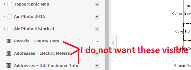

I have an application and services that contain related objects.  Is there a way to have the related objects work without having the related objects as tables in the layer list?  How can I hide these tables and still have the related objects work.  I have had some end user raise concerns about the tables being visible.
Anyone have any ideas?  Here is a sample:

Ian,
  To exclude all tables you go to the LayerList widget folder and open the LayerListView.js and comment out the getTableInfoArray portion of the postCreate function:
postCreate: function() {
      array.forEach(this.operLayerInfos.getLayerInfoArray(), function(layerInfo) {
        this.drawListNode(layerInfo, 0, this.layerListTable, true);
      }, this);
      /*array.forEach(this.operLayerInfos.getTableInfoArray(), function(layerInfo) {
        this.drawListNode(layerInfo, 0, this.tableListTable, true);
      }, this);*/

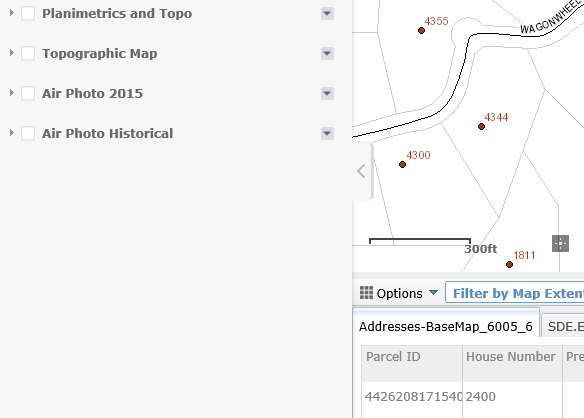

IanPeebles
Robert, you are the man!  I just did commented out those line and that works!  Perfect!  Also, my related objects still works.
