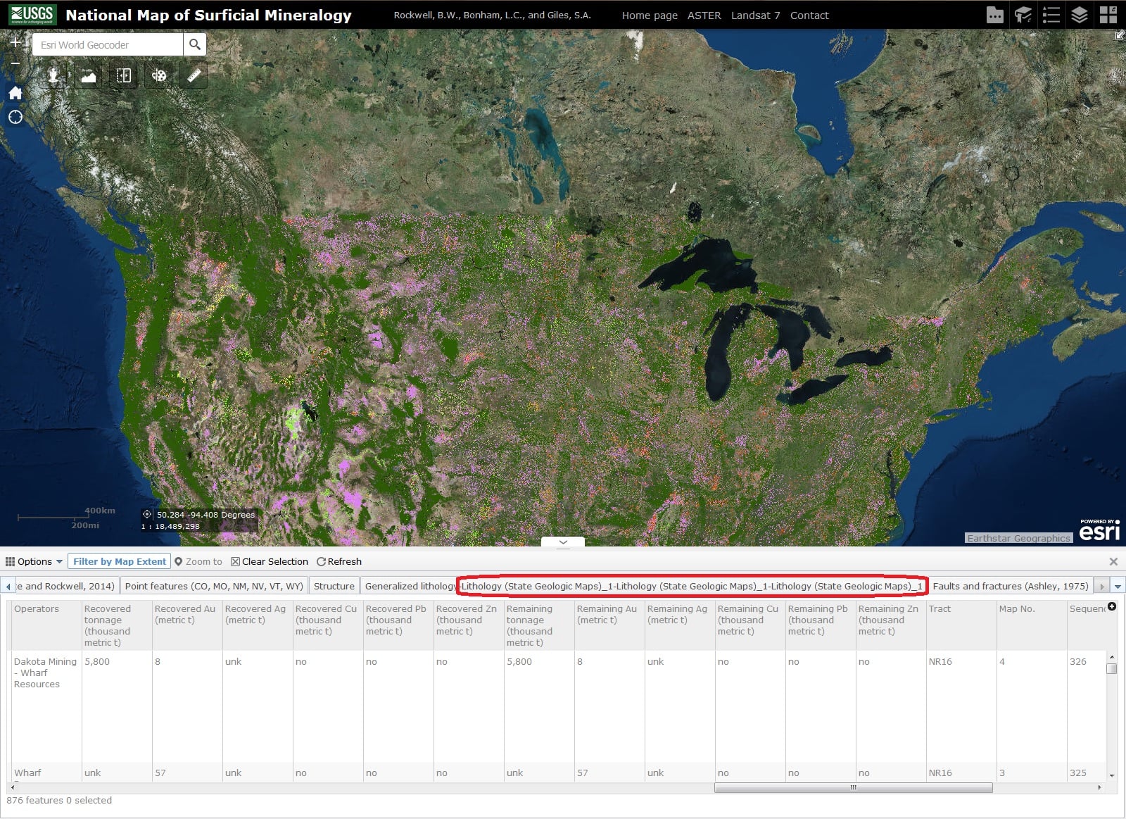

Hello,
In WAB Dev 2.0, how can I get names for layers shown in Attribute Table widget to be read from the Attribute Table config file:
\WABdev_2.0\server\apps\#\configs\AttributeTable\config_Attribute Table.json
Now, I apparently have no control over the names of layers in Attribute Table widget.  For some layers, but not all, unwanted strings (usually consisting of one or more instances of the layer "id") are appended to layer names (shown in red on attached image).  Even for layers without this erroneous name, I must change the layer names for the Attribute widget for various reasons.
The app in the image uses the custom LocalLayer widget to add layers, but the same issue occurs when AGOL Web Maps are called instead.  The same issue occurs in WAB apps made in AGOL (without using WAB Dev edition).
Any help or ideas would be appreciated.  My services are published using ArcGIS for Server 10.4.
Thanks in advance.

Here is a shot of another WAB Dev 2.0 app, this one calling an AGOL Web Map.  Note that problematic layer name in Attribute Table (shown in red) is on another layer than the one shown in map in previous post.  All services are the same as shown in shot in previous post.
This looks like a new "feature" (bug?) in WD 2.0 Attribute Table widget.  The Attribute Table config file is always synced with layer name from service, and thus edits of the attribute table config file are not read.
There were no such issues in WD 1.3 and older, and I could edit Attribute Table layer names in the config file.
