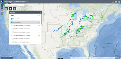

Thanks very much for letting me know -- when I use that example url this is the result I get. A big problem for me is that my organization's content security policies block so much that it is difficult to implement this tool or troubleshoot. Perhaps that is what is causing the problem.
http://mesonet.agron.iastate.edu/cgi-bin/wms/nexrad/n0r.cgi?service=WMS&request=GetCapabilities
