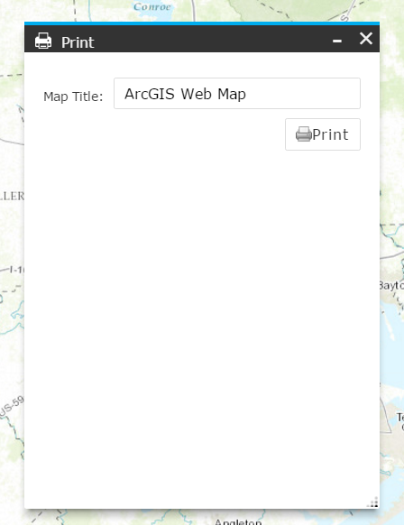

Hello All, recently we upgraded to WAB 2.2 and noticed that there are no Advanced setting button, title, format any more in the Print widget. Has anybody noticed it yet? how to fix it?

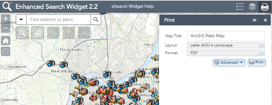

   Have you tried creating a new app in 2.2 and see if it exhibits the same behavior?
2.2 have the advanced put button for me.

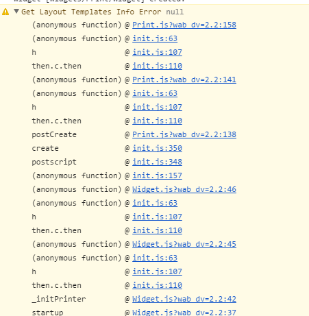

Thanks Robert for your quick response. The screen shot attached in my first post was from a new app built with WAB 2.2. I just noticed that there was a "Get Layout Template Info Error null" warning in the console.
Alexwang
Never mind. I put the wrong service URL. After i put the correct url, the Advanced Setting button shows up.
