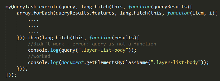

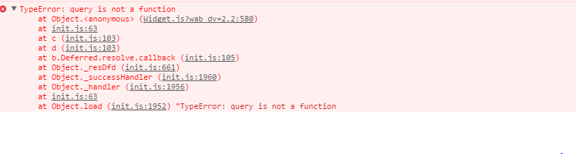

Hello, I wanted to get html elements for a class using dojo/query within then() of queryTask. Please see below. Using query(class) return a "TypeError: query is not a function." But it worked when i used document.getElementsByClassName(classname). What did I missed on the query way? Thanks!!!

Was is the name of the parameter you assigned the require to? Is is query? It looks like you have "esri/tasks/query" as well, so did you give dojo/query a unique var?

Alex,
   Do you have the require for "dojo/query" in you require list?

Thanks Robert for your quick response. Yes i double checked and do have "dojo/query"  module in the list.
Alexwang
lol... thank you, Robert. I have a local variable called query which caused the problem.
