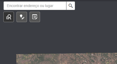

I have some widgets that were added by the widget manager and they show up on the screen. I would like to know how to make them visible according to the user's profile.

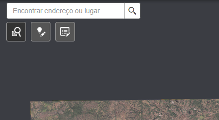

Here's an image of how widgets are displayed on the screen:

the problem is that when I set the visibility to false, the widget does not show its content but remains on the screen
