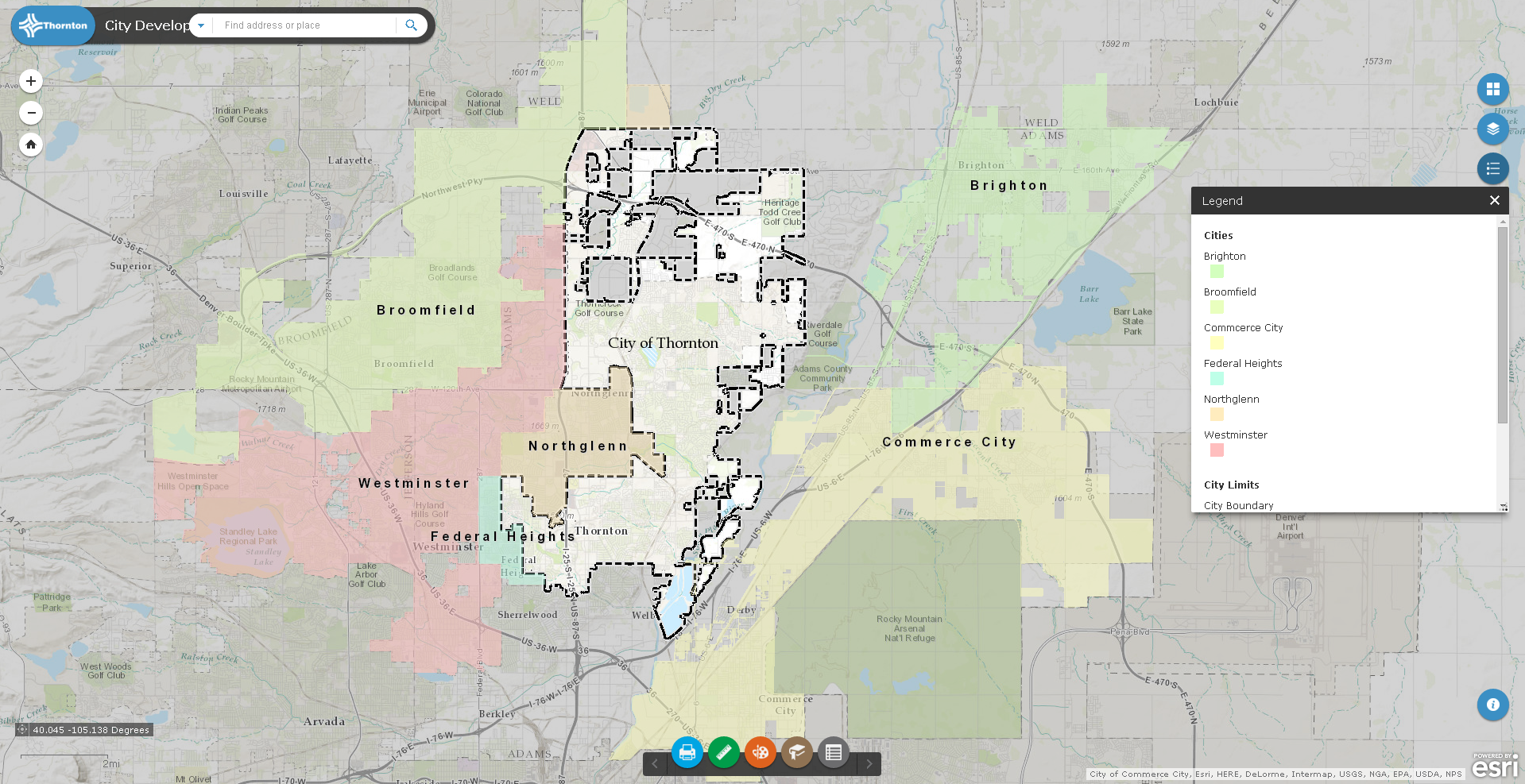

TylerDunn2
Not sure why this is happening. Might be because the logo is large, but I've dug into the themes and configs and cant figure out a fix for the life of me. I've attached an image. Anyone have any suggestions? Title is supposed to be "City Development".TitleIssue.png

More specifically adjust the bolded numbers in the snippet of the resize function below:
// Total width of the content in the header
          var contentWidth = boxSizes.logoBox.w + boxSizes.titleBox.w + boxSizes.subTitleBox.w +
              20 + boxSizes.searchWidgetBox.w + boxSizes.LinksIconBox.w;
          if(15 + contentWidth + offsetRight < winBox.w) {  // enough space to show everything
            this.domNode.style.width = contentWidth + 'px';
            var paddingLeft = 20;
            if(boxSizes.titleBox.w + boxSizes.subTitleBox.w === 0){
              paddingLeft = 15;
            if(searchWidget) {
              if(window.isRTL){
                searchWidget.domNode.style.right = boxSizes.logoBox.w +
                  boxSizes.titleBox.w + boxSizes.subTitleBox.w + 15 + paddingLeft + 'px';
              }else{
                searchWidget.domNode.style.left = boxSizes.logoBox.w +

Tyler,
 Because you are using a logo that is wider than programmed for, you will have to modify the Launch Pads header widgets resize function to accommodate this larger width logo.
TylerDunn2
Yeah I figured it had to do with the resize function, I just wasn't sure where to find it. I guessed it's somewhere in the "themes" folder, but I searched for a while and couldn't lock it down.
RobertScheitlin__GISP
MVP Emeritus
Tyler,
  Not sure if you are still asking exactly where to find the file but here is its location:
[app instal]\server\apps\[app#]\themes\LaunchpadTheme\widgets\Header\Widget.js
then the resize function.

RudoDuncan
Deactivated User
I changed the numbers in bold to 40 and 35 just to see how it would look and nothing changed.
MVP Emeritus
Rudo,
  Then yo are likely making these changes in the wrong location. If you are wanting to change a app that you have already created then you have to be modifying that apps files and not the stemApp.
