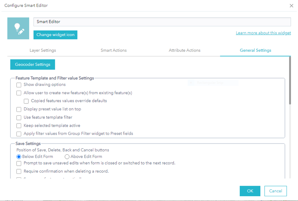

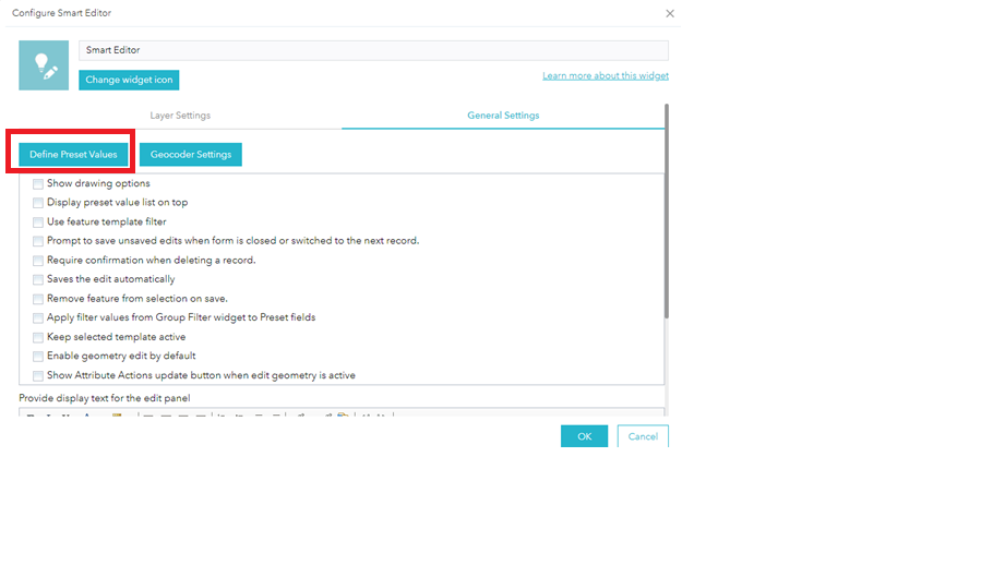

Hello everyone,
Smart Editor Widget is missing, in the General Configuration panel, the button "Define Preset Values".
Any suggestions in how to enable or make this button visible?
See attached screenshots of Portal 10.6 with the button visible and 10.8 with the button missing.
Portal 10.6Portal 10.6Portal 10.8Portal 10.8

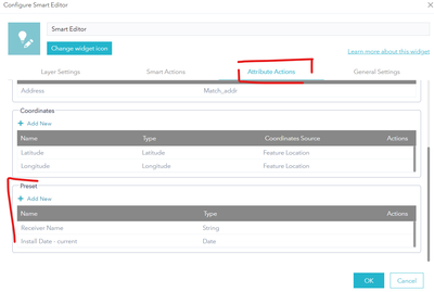

Hi @JoseSanchez ,
Presets are disabled from the Layer Settings and should now be setup from the section in the Attribute Actions tab.
Please refer to the widget documentation for more information: Smart Editor widget—ArcGIS Web AppBuilder | Documentation
