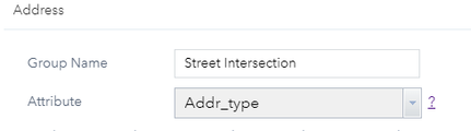

To get the street intersection value text, you would need to leverage the Address Attribute Action again, but unfortunately, we don't currently have a way to collect and store the value from the StreetInt returned by the Addr_type field. If you choose Addr_type as an attribute when setting up the Address Attribute Action it won't return useful information.
