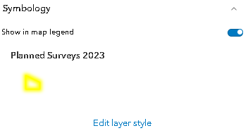

I do not want all of these options to show in the legend or smart editor widget in the web application. I changed the symbology in the web map to be single symbol and it looks like this:

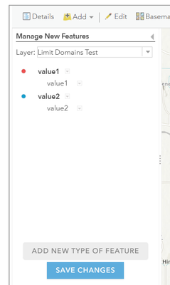

Thanks for your post. As you're specifying, "WITHOUT editing the symbology of the feature service" is a key element to your request: this means you can't simply edit the feature templates in the map as I would normally suggest below (this updates the layer's JSON):
