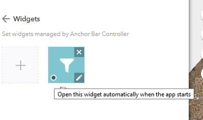

You can't get the filter to appear like a splash page, but you can click the circle icon to have a widget open with the app.
In addition, you can set the filter to prompt for a value and apply automatically. But there's no way to do this without showing the widget itself.

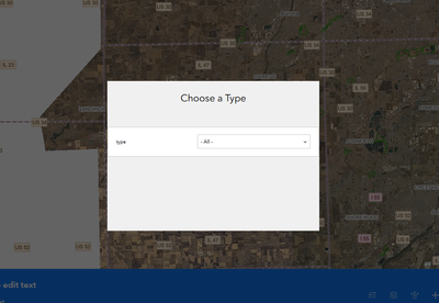

That said, you have a bit more freedom to adjust things and put widgets into a splash window if you use Experience Builder.
You should check that out and see if it can accomplish what you're going for.
