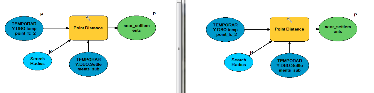

A simple model that uses the Point Distance tool.. Finds out the settlements within 10km distance of a point.. The version on the left uses a parameter which allows locating the input point when the model is run. The one on the right uses the point feature within the layer and executes the model without an input point parameter.
When the model on the left is run, the very same point is located and the model is executed. Results are of course the same in ArcGIS Desktop.

Then the geoprocessing services are added as WAB widgets to a web application in Portal for ArcGIS. While the model on the right continues to give the same result, the one on the left starts to calculate distances in Web Mercator causing 20% to 30% differences.
I know the maps in the portal use Web Mercator but;
1)  Why the projection of the map effects the model on the left but not on the right? Same model, same layers.
2)  Why the projection of the data frame does no effect on any of these models in ArcGIS Desktop?
If the explanation is "the projection comes from the map when the input is a parameter but comes from the layer when the input is not a parameter but this is only the case in Portal for ArcGIS but not ArcGIS Desktop(with a Web Mercator projection)" then this is definitely a bug.

The projection of the data frame projects the layer on the fly just for viewing. But the data of the layer remains unchanged. So it has no effect on the result.
If you use the geoprocessing service in WAB and draw point on the map, the spatial reference of the point is Web Mercator. You can use GeometryService to project it to the proper spatial reference before send to the geoprocessing service.
