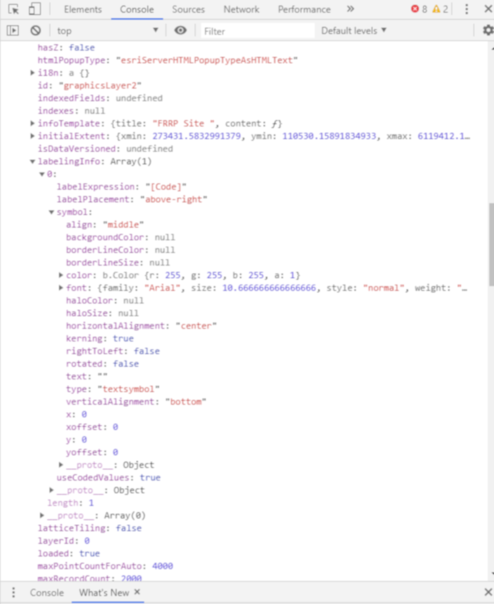

and when I log out the result layers info, all of the labeling info appears to be present in the layer properties.

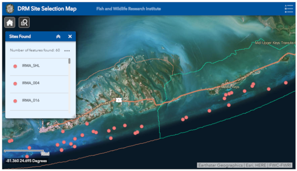

Here is the query result layer not showing any labels:
There must be something else I need to be doing to get the labels to show, but I can't figure it out. The only thing I can think of is that either something is missing in the label properties, or it has something to do with the rendering. Do I need to add something to the code snippet below?
