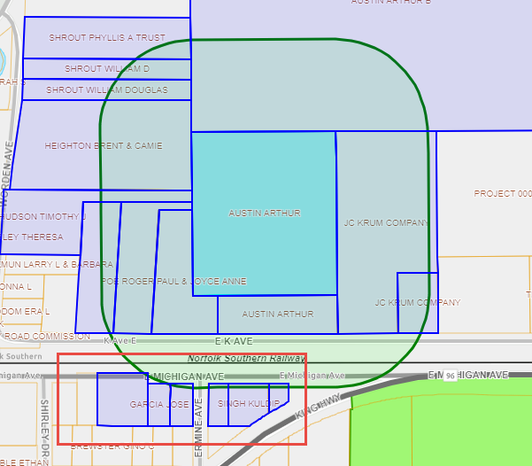

I’m using the Public Notification widget and when I try and deselect some parcels I don’t want, nothing happens. I’m using the CTRL + draw option, but the screen just flashes for a moment and then comes back to the same selected set. I’m using the current AGOL release. Is there a bug?
I saw this post- but didn't work as shown.
TimConfare2
It was my understanding this was supposed to have been fixed with the latest release of WAB but it still didn't work after testing it out with version 2.14.  I contacted the development team and found out the intention of this fix was to remove parcels from your original selection and not the selection from the buffer.  This was a disappointment to me as my users need the ability to remove some parcels that have been selected by the buffer.
If you do the cntrl-draw to your original selection it will delete it and redo your buffer.
