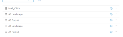

Hello everyone, I'm trying to configure print functionalities for my website.
I've configured the "default" print service in the portal, using the url https://mysite/webadaptor/rest/services/Utilities/PrintingTools/GPServer/Export%20Web%20Map%20Task, and from the portal I see the various layouts available.
I've configured the print widget following the provided documentation, but now I'm able to print only using MAP_ONLY layout. Any other layout generate this error: "Error executing tool. Export Web Map Task : error raised...(path to file on the server) (path to file on the server) Failed to execute (Export Web Map). Failed to execute (Export Web Map Task)."
I see this message in the chrome developer console and also in the arcgis server log messages (logs set to debug, but only this SEVERE message appears).

Is your layout registered to the server?
DiegoGuidi
I'm using the default PrintService "/arcgis/rest/services/Utilities/PrintingTools/GPServer", that (I think) has several layouts already available and ready to use (at least from my understanding of the documentation).
The GetLayoutTemplateInfo task returns the same layouts that I see also in the portal configuration page, like "A4 Portrait" and "A4 landscape".

finally I had a chance to install the patch and problem disappeared.
thanks for the support.
