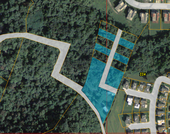

1. I select a parcel using selection tool

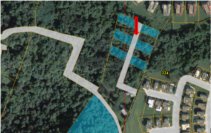

I use Cut/split tool to separate the parcel selected in 3 parts.  I split using the graphic below,
The tool also splits the polygon right next to the selected one even though it’s not selected and create a new polygon, polygon that I do not want that's why I didnot select the parcel.

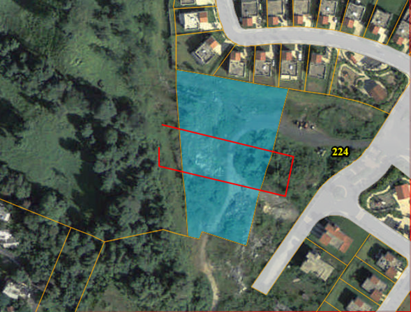

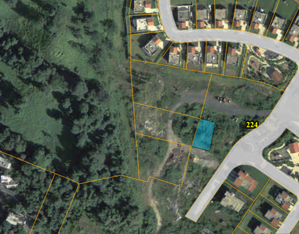

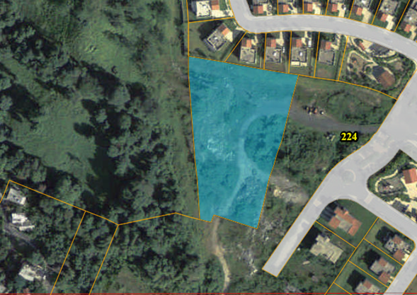

2. While splitting a multi part polygon the tool generates multi part polygons instead of individual polygons.
In this example I split the multi-part polygon by drawing a road that goes through the parcel. When I finished it created the two multi-part polygon. The one in the image above and the one in the image below.
