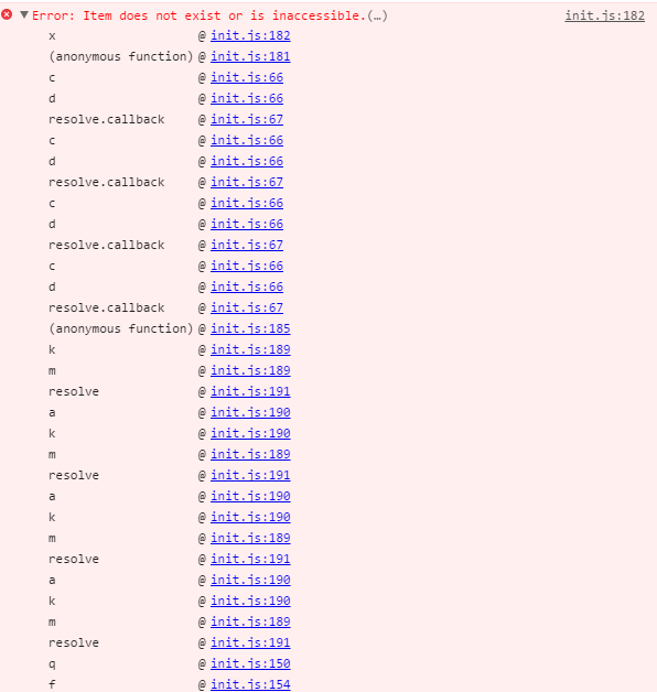

Thanks Robert, I'm getting this: "Error: Item does not exist or is inaccessible."  Unfortunately I don't know the mechanics to know where it's failing.  WAB did ask my permission for my AGO account and it's showing I'm logged in in the upper right.
My machine is located inside my firewall, but has full internet access.  Does that matter?WABError.png
RobertScheitlin__GISP
MVP Emeritus
Steve,
   Open the signininfo.json file located in your [install dir]\server folder and  copy the context (except the appId make sure to remove that text) and paste them here.
