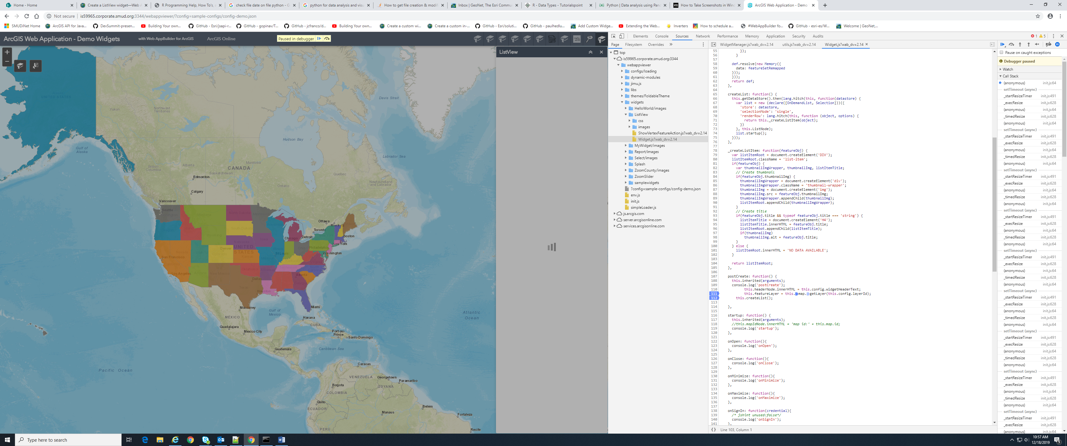

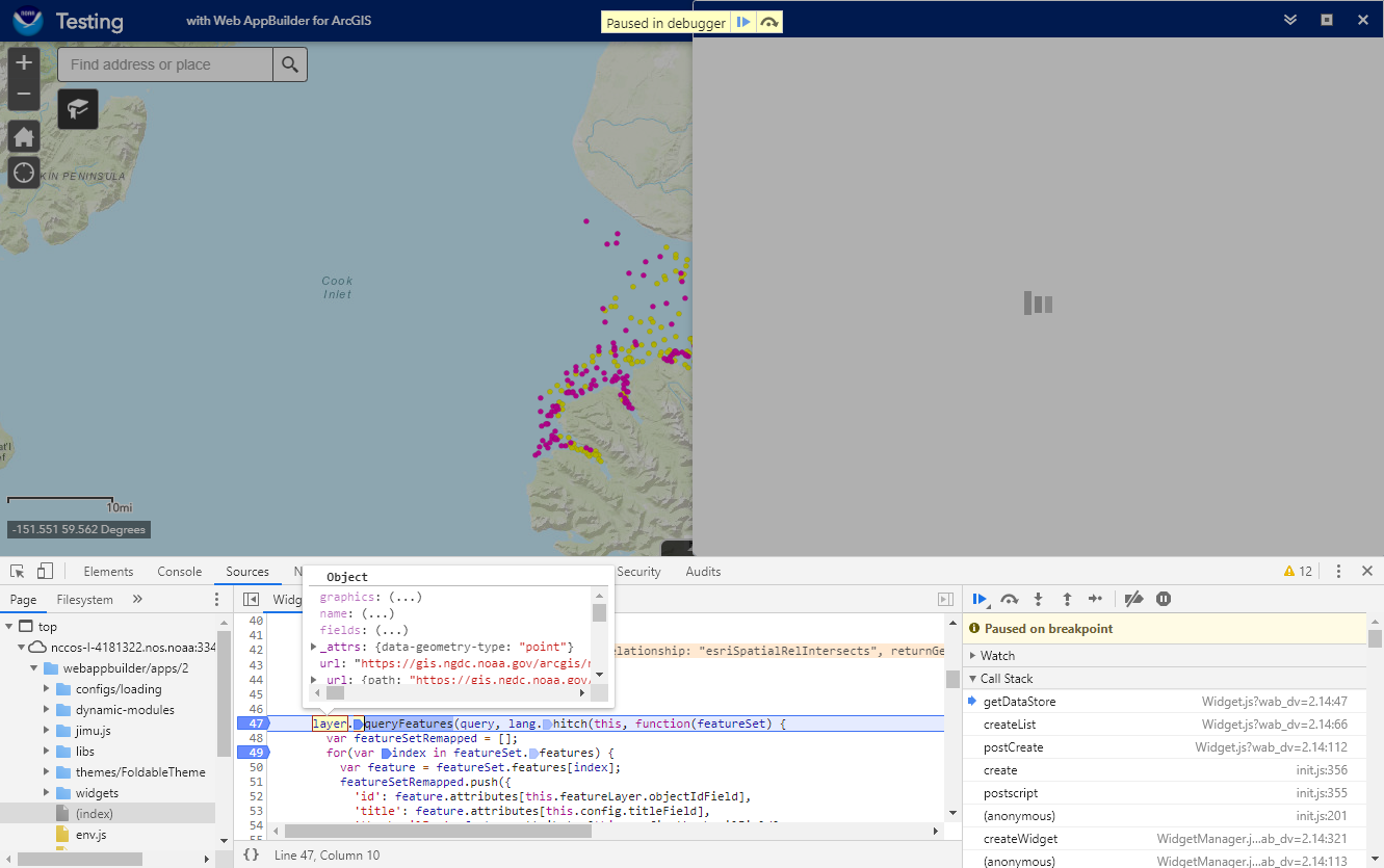

When I hover over my this.config is shows undefined.

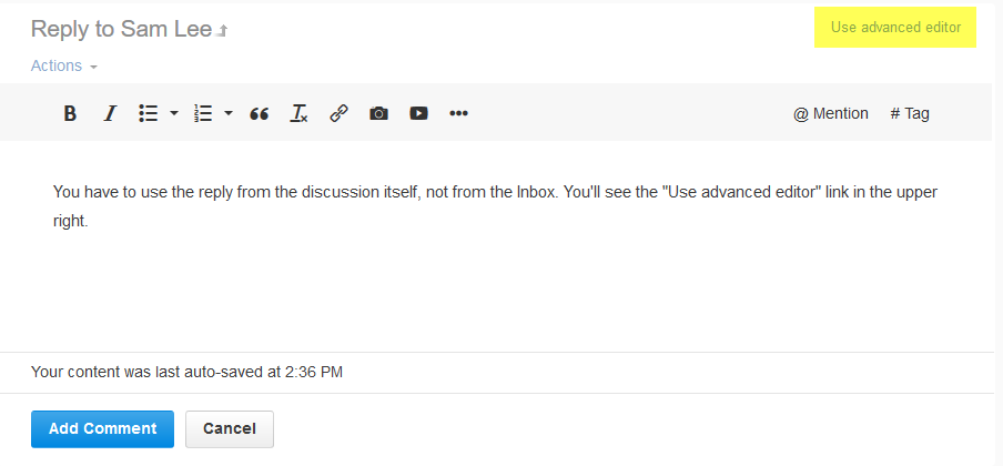

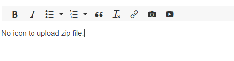

SamLee1
No icon to upload zip file.
KenBuja
MVP Esteemed Contributor
You have to use the reply from the discussion itself, not from the Inbox. You'll see the "Use advanced editor" link in the upper right.

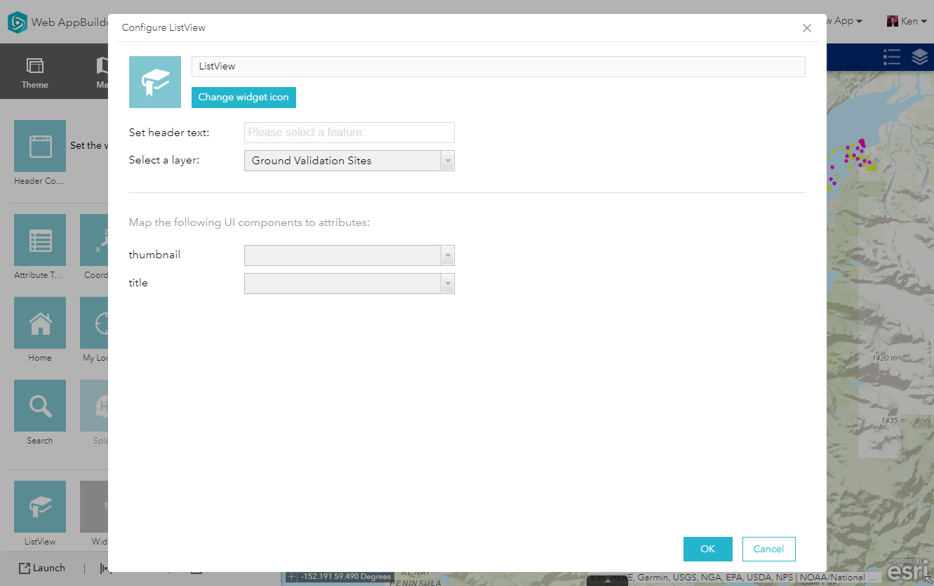

The widget works properly for me, with this.config getting populated properly and the layer instantiated.
In your app, have you added a map and selected a layer in the widget settings?

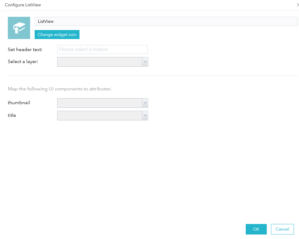

How did you get to the Configure ListView window?
I just realized that you are on the server not the client.
This is what I get:
But after I click okay and the widget this happens:
KenBuja
Your problem is that your map doesn't have any layers. It needs at least one layer to properly make "this.config". I tested with an empty map and got that same error.
