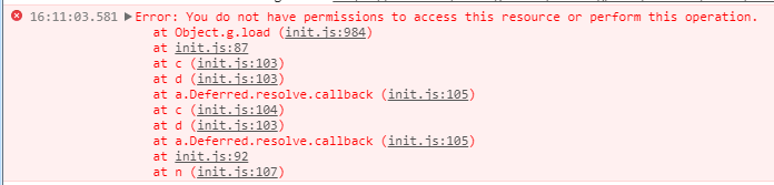

On loading of WAB app created in WAB Developer 2.3 I am getting a error.  How would I track down the source of this?
This only occurs when Layers List widget is included.  All layers in the source web map are set to public share.

As a test, I only have the LayersList and Legend widgets in the deployed application.  I've also removed all layers/map services from the source web map.
I still receive the error above!
Any idea what is causing this permissions issue?

In an effort to eliminate that possibility from the equation, I removed all services from the web map!  It's totally empty!
I've got a ESRI support case working now -- I suspect it has to do with the fact that my AGOL account is an admin role and perhaps applying some extra level of security to any WAB that I build and deploy.  Another developer here without that admin role does not get this secondary login challenge with his WAB deployments.
