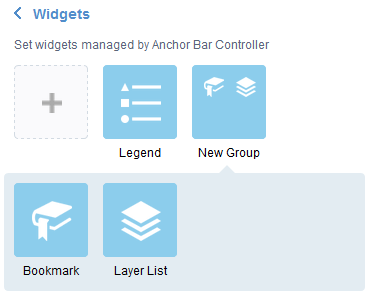

If I use the Launchpad theme and group a couple of widget together on the Anchor Controller like the following image:
The group appears on the anchor controller and when opened I have the option to drag the group around the map:
This is great but it has a very strange behaviour; its is like the group is fixed on its right hand side, as you drag it around the screen if you go left the widget width gets larger and if you go right it disappears apart from the icon and the close cross.

We use 'dojo/dnd/move' to handle move events. It only respect two style attributes: top and left.
In launchpad theme, when group widget pops up. We set its right attribute to position the widget. So when drag and move the group widget, the left attribute is calculated dynamically but the right position is fixed.
It is a bug and will be fixed in next release.
