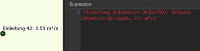

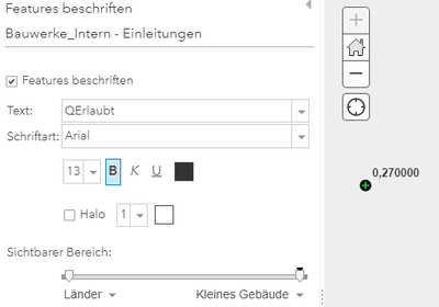

Before:
Create a label expression:
"Einleitung " + $feature.OBJECTID + ": " + Round($feature.QErlaubt, 2) + " m³/s"
// or, with newer syntax:
`Einleitung ${$feature.ObjectID}: ${Round($feature.QErlaubt, 2)} m³/s`
After:
In Pro, it's the same.
