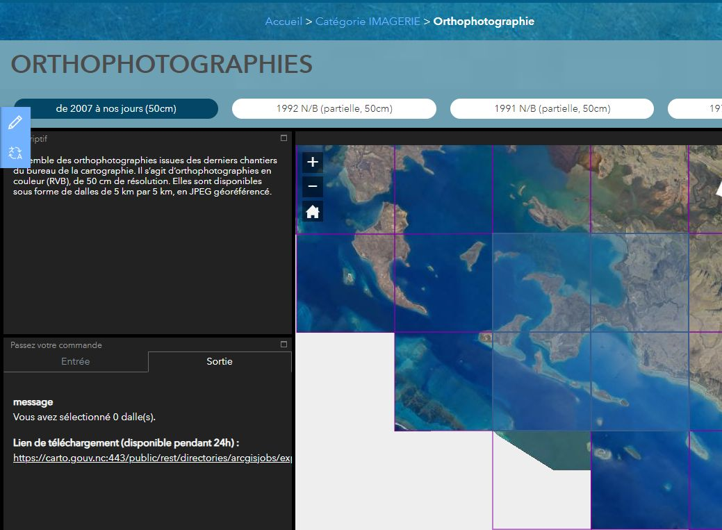

The process takes place without error, the zip file is indeed generated by the geoprocessing service, but it does not contain the files resulting from the selection (only attachments that we add when creating the zip). We have a message informing us that the selection is empty whereas 4 elements have been selected on the screen.

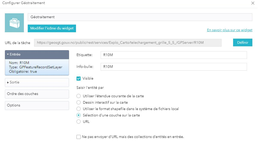

We feel like the 'Select Layer on Map' option in the AGOL Geoprocessing Widget no longer works as it did before the AGOL update.

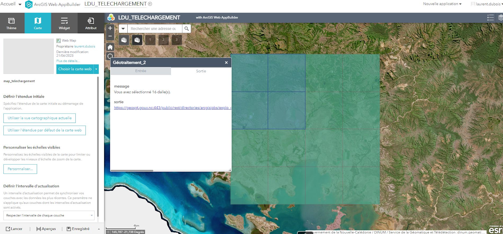

We tried to reproduce the issue in a new app builder web application that uses the same geoprocessing service, and we also see an issue with the selection on the map.
The option 'Selection of a layer on the map' does not seem to work correctly because it returns all the elements of the selection layer (16 elements) and not just the selected elements (4 elements).
For your information, when we modify the configuration of the widget for a selection by a .shp and no longer on the map, the process works well and the zip created is correct.
