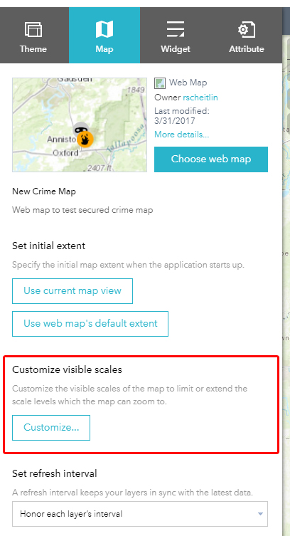

   In WAB you can specify more LODs in the app:

My scenario is
1.Created basemap with 4 scales only (1:500000,1:200000,1:100000,1:50000).
2.Through query operation(custom tool or widget) i got the feature set (dynamically) . The feature set will have the extent and that extent is not falling into the base map scale. .For example I may get scale for the featureset 1:2500 or 1:7000 or 1:8000 .
3.In that case Can i zoom to 1:2500 or 1:7000 or 1:8000 ? . Is it possible to view the basemap details in 1:2500 or 1:7000 or 1:8000 .
4. The featureset scale 1:2500 or 1:7000 or 1:8000 is not constant , this will vary depends on the user query.
RobertScheitlin__GISP
MVP Emeritus
Mohan,
   You add some more scale like 25000, 15000, 10000, 7500, 5000, 2500 using the info i provided above and WAB when it zooms will use the closest scale available when zooming.
mohannainar1
Robert,
Ok after adding the additional scales (25000, 15000, 10000, 7500, 5000, 2500) it will zoom to closest  . But the basemap details will not display am i correct ?. Because I have not created tiles  for these scales  25000, 15000, 10000, 7500, 5000, 2500 . Is my understanding correct ?
MVP Emeritus
correct
