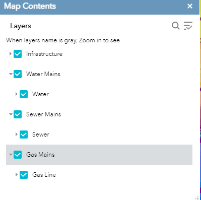

The first way is within Pro I set up a map that has groups defined in it and when I load said service into a the Portal Web Map it honors those groups.  See below my Corp Limits is set up a group with the different type of Corp limits below and the Parcel layer is outside the group.  So I can uncheck the different limits individual or uncheck next to Crop Limits and it turns off all layers within the group.
The Second way we do this is by publishing services for each category and then loading each service into the Portal Web Map.  Since they are separate services then it asks like a group layer in the map contents.  So in the below example Infrastructure, Water Mains, Sewer Mains, and Gas Mains are all different services.
