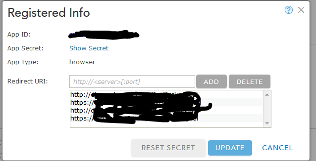

In our enterprise ArcGIS Online site, we will have multiple developers that will be using Web Application developers addition. Since I was the first to install/use and register with ArcGIS Online, the "Web AppBuilder for ArcGIS" web-mapping-application was created under my "My Content", with my computer registered for the redirect (with help from the "correct" answer here: Re: Migration Migraine ).  All works for me.  I was also able to add a second machine that I work on, and that also works for me.
However, when I added the other developer's machine to the same application, it did not work for him).  I'm assuming that is because this application is not shared and of course, he has his own named-user account.

For what it's worth, I haven't received any true authoritative answer to my specific question, but Robert's comments made sense and could apply to what I needed to test.   This prompted me to write my first blog Tips and Observations for getting Web AppBuilder - Developer Edition Installed  if anyone is interested, but bottom line (clip from blog) regarding this topic
  • A WAB folder (and startup.bat file) are pretty much linked to on AppID – although there are ways to shift or change which one.
  • Each user should have their own application/AppID created by them, in their own My Content
  • Multiple machines for one user can be registered to the same AppID, if desired. The WAB stores the applications being created in the local drive, so these are not necessarily shared between machines…although I think they could be setup to work that way.
  • One machine could be registered to more than on AppID, if desired and if multiple WAB startup folders exist.
And, if your install gets messed up because the appId wasn't available or it was messed up, there are fairly easy ways to fix the problem.

  I was referencing the need to register the Deployed App. You can choose to use an already registered AppID or you can create a new one (I prefer to add a new one for each deployed app).

It looks like the registration information is stored in "\arcgis-web-appbuilder-1.2\server\signininfo.json"

I would say yes, it is with a duplicate of the folder, since you put the AppID in when first starting up the WAB....at least to keep things clean.  But I suppose if you really wanted to switch between, you could mess around and change it, but I don't know the benefit of this. (What us it you are trying to do?)   I actually use many folders (machines and versions) with the same AppID....so if can go either way.

Each user would have to have their own AppID related to their AGOL named user.  I know others have attempted to have a central shared location for the WAB folder with several developers, but I'm not sure if this process was ever successful.  I think the hang-up would still be that the AppID still needs to be registered.  Since I am the sole developer of the WAB I'm working on, I have not tested any of those scenarios.  I'd say, give it a try.  Just because something isn't "as designed" doesn't mean it cant be done.....but be aware that you still need to keep within the legal limits of the software (which again I think is the "named user" tie in) even if you can get it to work.
