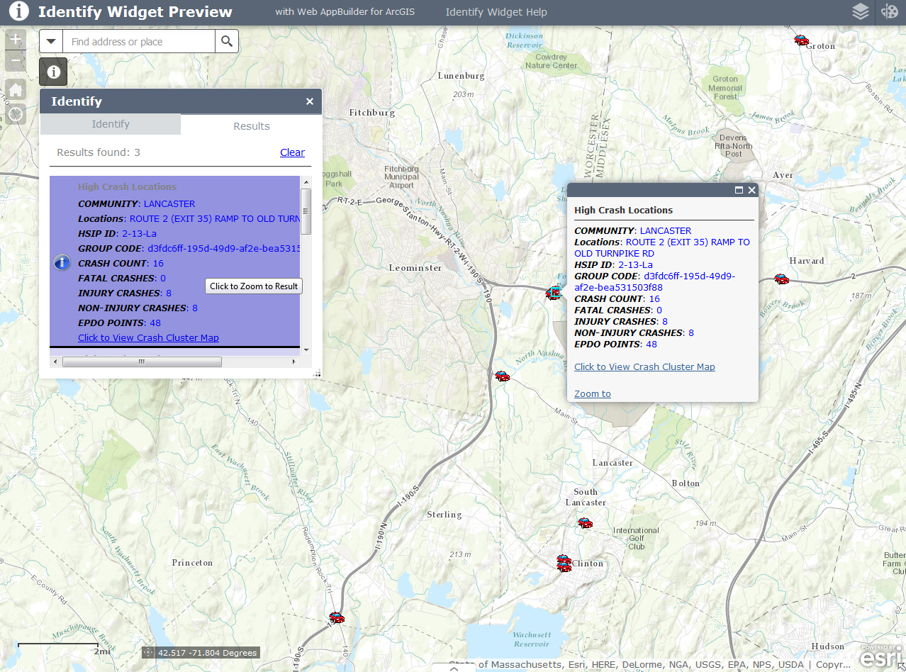

My apologies, sometimes by brain gets in the way of itself..  I 'misspoke' I meant to say the service, within the WebMap, end at MapServer, without the /0.
And if it matters I am using Portal not AGOL.
RobertScheitlin__GISP
MVP Emeritus
Jason,
   Portal adds a level of complexity... As I can not test your exact environment. I added your layer and looked at your config_Identify.json and matched it exactly on my end and I am successfully identifying your data.
