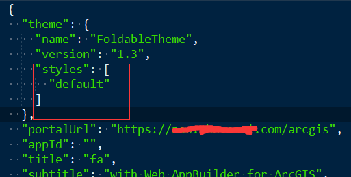

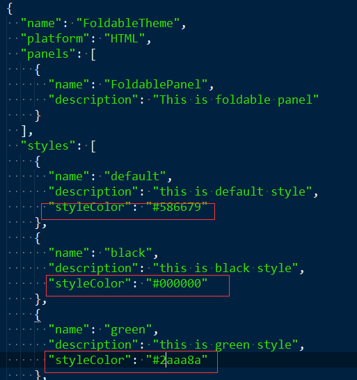

ZeZhengLi
Sumit,
First,you can access a style array from `this.appConfig`, the first one as the selected style. If there doesn't have styles property, use `default` as default.
Second, you should send a request to get the manifest.json of theme manually.
The `styleColor` is you need.
