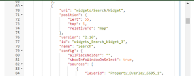

@FayGlunt , you can view the .json of the web app in ArcGIS Online Assistant. Use this link to sign into your Portal https://ago-assistant.esri.com/. Select "View an item's json" in the dropdown, then search for the app you are looking. In the json you will see the version of the widget you are using.
eg. This is the version of the search widget my app is using, as seen in the AGO-assistant tool.

I can see we are still using version 2.25 of that widget.  Do you know by chance, how we get the the latest greatest version?
