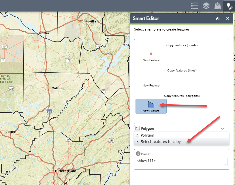

1. Select the layer's template you would like to append the new features into.
2. Select to copy features.

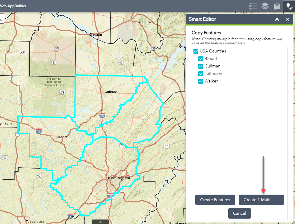

3. Select the features to be copied.

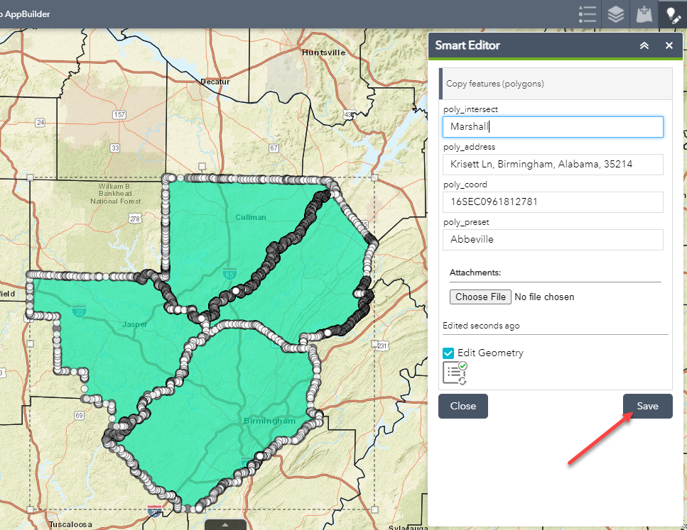

4. Select to Create Multi-Geometry (Multi-part) features
5. The multi-part feature is added to your target layer.

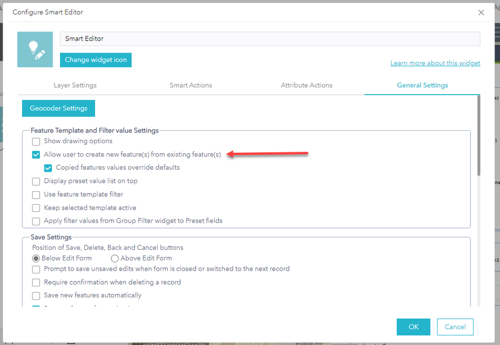

Enabled this capability in the General Settings of the widget configuration.
