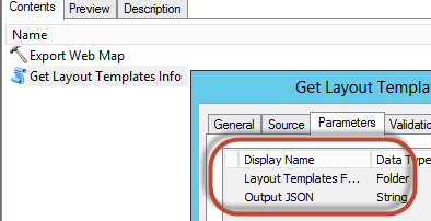

Below is the info Tanu forwarded to me:
You need to create a script tool with following parameters
nb: the name of the first parameter shouldn't matter.
  Again, this script/task only to provide metadata information for each layout templates… which helps Web App Builder’s print widget to show those options in it.
This requires running a python file to generate the script tool and I do not see a way to attach the script (GetLayoutTemplateInfo.py).
