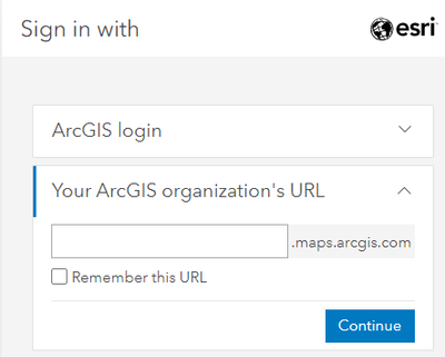

InokaWijekoon
how can I login using on premises enterprise portal account ( xxx.xxxxsl.org/portal/home/) here using as a ArcGIS organization URL?
