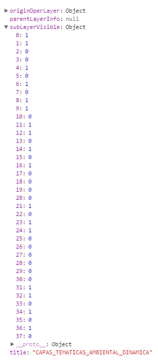

I want to get the information about sublayer visible, but, from operational layers (this.map.getLayersVisibleAtScale())
In widget legend, this information is getting from layerInfos class, but, Is there any propertie like this with the operational layers?
I want something like this:

Robert, if you print the map object in console, you can find it:
Map> ItemInfo > ItemData > operationalLayer > array (depending).
That is that I mean.
This layers has not subLayerVisible attribute like image above, this layers has this attribute instead:
I want to make a widget like legend widget, that it's listening when a layer is not visible at a current scale. I thought that LayerInfos class (in jimu.js) would help me here, but no. LayerInfos object only listen when I disabled a layer from LayerList widget.
