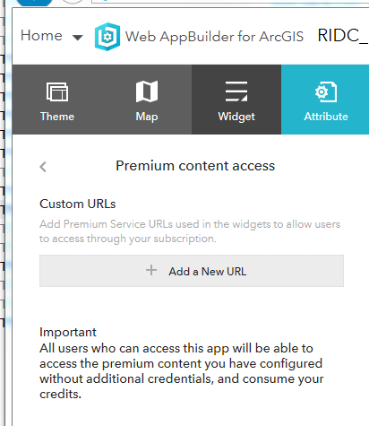

Web app builder shows premium content access option in "Attribute" tab, with custom URLs that are used in widgets. I want to use create watershed analysis service and let public use certain limit of credits that I have available to my organizational account.
I have tried different settings here, but nothing seems to be working. I public view of this web app, when ever user clicks on widget for running analysis, ArcGIS Online takes the user to sign in page for my organization.
Yes, this is possible. You will need to add the Premium Service as a new item in your ArcGIS Online organization and save credentials with it. Then share it with everyone. Then copy the item's REST URL (this is located in the lower right corner of the Item Details page, Overview tab) and reference this URL in the Premium content access panel (in your original post screenshot) in Web AppBuilder, as well as the widget that will be using the Premium service.
Help topic: Configure Premium Service
Once this is enabled, when you share your app - your end users will not be prompted for a login when they attempt to execute the widget.
