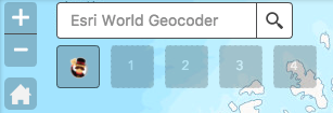

I'm sure there is some simple config setting I'm missing, but how do I completely hide a WAB widget icon from the built app? I've tried things like: setting "visible": true in manifest.json (doesn't load widget at all), setting visible property false on widget via "this.appConfig.widgetOnScreen.widgets" (changes property to false, but widget is still visible).
In builder:
In app (don't want this icon):
I'm open to the notion that there is a more fundamental setting I'm missing, like how to specify the widget as "not on-screen" right from the onset. Any help appreciated!

OK, It looks like the only piece of info you are missing then is that off panel widgets have to be manually added to the main config.json for the app or they need to me manually added to the \client\stemapp\predefined-apps\default\config.json

My manifest.json indicates that this is on off-panel widget ("inPanel": false). Are there additional settings controlling whether this is on- or off-panel? If I change to "inPanel": true, then a panel opens when I activate the widget in the app.
RobertScheitlin__GISP
MVP Emeritus
DarrenWiens2
MVP Alum
Thanks, Robert Scheitlin, GISP‌! I'll just post that this is as easy as adding the following to the widgets array in the main app config.json (not the widget config.json):
  "uri": "widgets/MyWidget/Widget"
