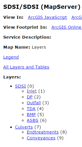

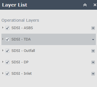

I am using the custom widget layerlist and I am trying to group layers. I already grouped the layers in ArcMap, as you can see in the services directory screenshot. However, wab lists the layers and not in group (last screenshot). Any ideas? Thank you.
Services Directory

   There is no support in the Local Layer Widget to manually group layers. If you add the whole map service as dynamic then the layer grouping that is defined in the map service will be honored.
LefterisKoumis
Thanks.
Is there a way to avoid to show the name of the folder that the layers are located under on the services directory?
For example, from the screenshot instead of SDSI - ASBS to be just ASBS.
