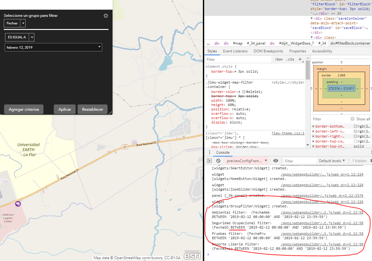

We have a problem with the Group Filter widget to filter the dates of a feature service. In the first App, the widget worked fine, but when I copy to replicate the app for production environment produce an error.
In both cases, the filter is on the date field, where the records contained in a full day should be shown. In the App that works, send the correct request using Between as seen in the image

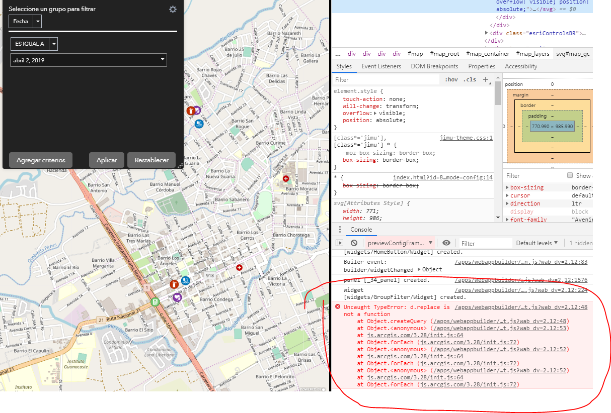

However, in a copy of the same App, when applying the identical filter, it sends another request to the server that produces the following error.
How could I solve the widget Group Filter date problem?
