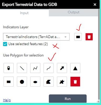

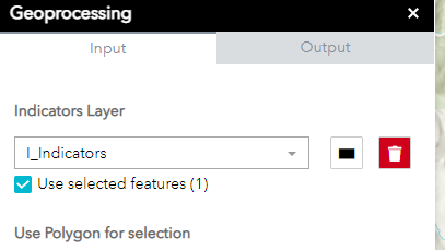

The Geoprocessing widget is completely ignoring the Use selected features checkbox.

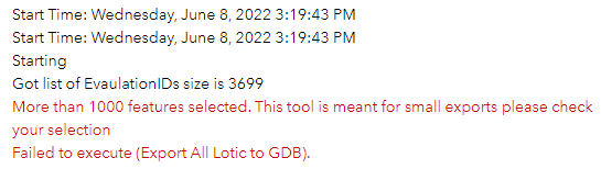

If I run the tool like this I get all features sent to my script.
I get the whole thing
If I use the black box in the widget and select them that way then it does work.
Is this a known bug?  Or do I have to set something differently?  Not seeing any docs or posts on this.
Thanks for any help

Update from more testing
I can get draw box next to the layer name to work.
I can get a second field that asks for a Polygon to work
I can get a query result layer to work
But the use selected features does not
Seems weird to have the box there if it is not supported.
I am just using indLayer = arcpy.GetParameterAsText(0) in my code - maybe I need something else?
I cannot seem to find this new checkbox in the help either.  Anyone seen it?
thanks

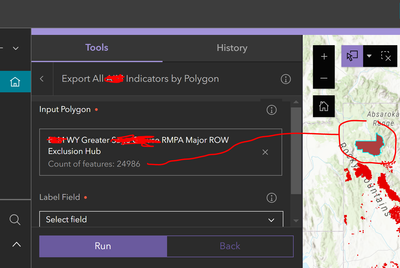

We are mostly still in WAB as ExB is still missing so many things.  We are building and testing now though.
But using the latest on AGOL the widget does not respect selections from the selection widget.  This was listed as a known issue fixed in 11.4 posted here  https://community.esri.com/t5/arcgis-experience-builder-questions/use-selected-features-as-input-to-...
But we are using AGOL so not sure what that has to do with server?
The one spot said to use Set as Analysis input.  I do that and again it still has all the features and not what is selected.  Well wait it works from some places and not others.  It seems similar to WAB in a way.  If I select using the select widget it gets ignored.  If I select in the widget then use set as input it works.  If I select then Set as from the layers list also ignored.  Been confusing to users.
thanks a lot
